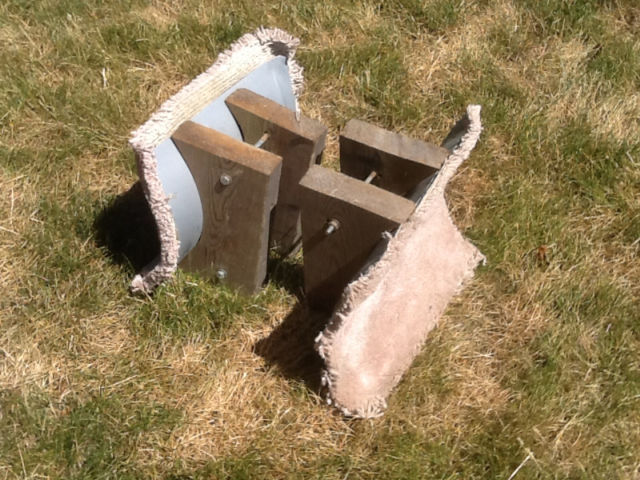

One trailer will accommodate many Cats with a simple jig, knocked together from a piece cut out of 10" diameter plastic sewer pipe, a few countersunk SS screws, & bits of 2x4 or 2x2. Attach the bits of lumber so the roller will just fit into the gap.
I use V bunks at the front, rollers at the rear. If you need to move a round hull cat, simply drop the jig over the rear rollers, then secure the Cat. This is how I move the H18
