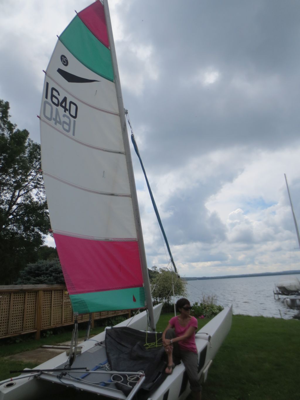

This boat was brought over to Canada when the owner Paul Ruddock immigrated to Canada, I bought it privately the summer of 2017.
The sail shown is a spare the previous owner purchased from a chap near Newcastle.
i wanted a small performance Cat that was easy to launch, easy to right, as it will be sailed solo, with jib & trapeze.
I keep it at my summer home on Lake Simcoe, Ontario, Canada.
The lake is large, 50km x 40km, & can be obscenely rough during high winds. I'm on a protected bay, with smoother water, & have a Hobie 18 Magnum, & a Nacra 5.7 for the rougher conditions.
I don't have access to organized racing, as found in the UK, we are mostly recreational sailors who blast around the lake for fun

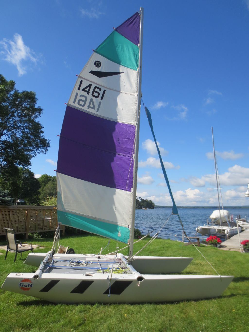

Hi Chris,
Do you live in the GTA? The Sprint 15 mast should be set up to be perpendicular to the boat, i.e. vertical or very slightly forward. The rigging is typically looser than other cats, so that you can easily move the mast to around 80 deg, then with a little effort you should be able to rotate it to 90 degrees on the land with no sail on the mast as the rigging tightens. Then you are in the right ballpark and the mast should rotate as it needs to in most wind conditions.
George
edchris177
Posts: 28
Joined: Sat Jul 29, 2017 11:39 am
Re: 1461
Post by edchris177 »
Thanks George, that helps me immensely. I'm used to running a fairly tight rig. We run some rake, & quite a bit on the N5.0, as we sail it in quite big waves at times, it pretty much prevents any threat of pitchpole, unless you really try!
I found the short bit of wire that goes at the top, I'll insert it & remove the 10 hole adjuster at the furler.
I was thinking the fitting at the mast hound,(quite clever for those who need to break things down to cartop), by sticking forward an inch or so, created a lever that wanted to rotate the mast. I had attached the swivel to this fitting,(only having the somewhat dated Assembly manual). I'll insert the short wire as I've seen after perusing pages of photos from the Shanklin club website. It looked like they mostly use very little to no rake, I was surprised to read you actually use a bit of forward lean.
Measuring from mast to traveller rail, I was at 22' 3".
I live north of the GTA, & have a summer home on lake Simcoe. We store the Cats fully rigged all season,(except for mainsail), on modified SeaDoo lifts.
If any of you folks are over here during the season, shoot ma a line, I have beds, & 3 fully rigged Cats. It would be great to have someone who really knows the Dart show me a few things.
There are two gentlemen about a mile around the corner who said they raced together in the UK for 30 years. One has an H16, the other a Dart 18. I gave them my Nacra 5.7 (19') one day in a good blow & they were quite impressed, at both the speed & how well it parted the seas.
